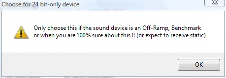

When i like to set it to Dac needs 24 i get this error.
