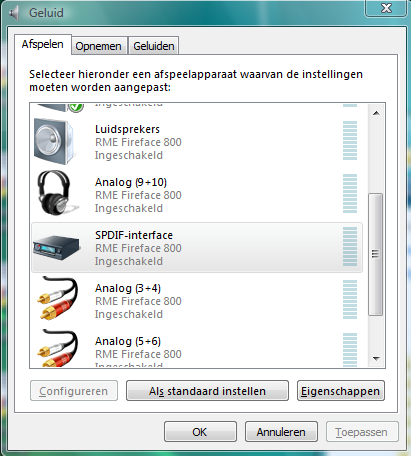

« Reply #21 on: March 26, 2009, 11:39:04 am »
Hmm ... scratching
Mani, what does the DAC Test show for sound device on the second line of the report ?
FYI : Selecting the sound device for Engine#3 is just new, and things may be wrong.
On quite some other note (but maybe not) ... I now see that I don't have Speakers for the RME. I only recognize them from XP drivers ...
See below. It should be Aanalog etc. ...

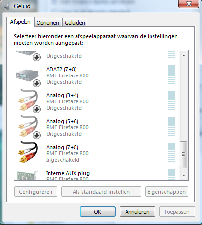

« Reply #22 on: March 26, 2009, 12:37:50 pm »
OK, so here are some images:
1) my devices
2) my XXHE settings
3) DAC Test with internal sound card DISABLED
4) DAC Test with internal sound card ENABLED (note: I have NOT changed the settings in XXHE - I still have the RME chosen)
With the internal sound card enabled, XXHE stops recognizing the RME (but it is still set as the default in Vista). If I play a track, it comes through my internal speakers.
Weird, no?

« Reply #23 on: March 26, 2009, 12:43:12 pm »
Sorry, last image is wrong - this was the result after enabling the SigmaTel, but before rebooting.
After enabling and rebooting, this is the result. Again, the RME is still selected in XXHE settings.

Posts: 16854
« Reply #24 on: March 26, 2009, 01:51:52 pm »
Yup, that would be my fault. I don't know how or what, but it must be.
Thanks.
And Andrew, SORRY ! you will be dealing with the same problem I suppose.
I still wonder where you get that "Loudspeakers" from. Mani, this might be related to your HDCD culprit thing ?
