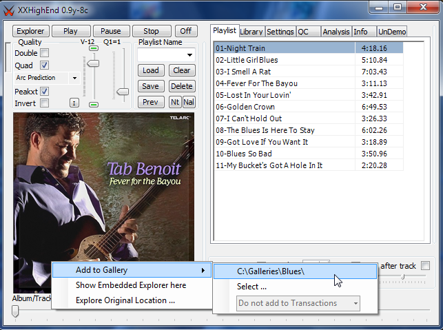

« Reply #5 on: March 14, 2010, 08:59:29 am »
Only two days ago I discovered a nice way to do this fool (you may do this for years like this already Happy) :
Start XXHighEnd. Clear the PLaylist Area.
Start Explorer, or just have/leave that open all the time during ripping.
Go to the folder which contains the tracks of the new album.
From there, drag at least one track onto the Playlist Area of XXHighEnd.
Rightclick on the Coverart at the left. Choose Add to Gallery.
Done.

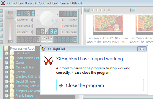

« Reply #8 on: November 11, 2010, 11:30:22 pm »
1. Go to the Library Area. At the bottom fill in the path to the new albums.
Note that everything you fill in there, will not be shown later at retrieval, thus, g:\wav\JZHolidyAquisitions\ is what you don't want to show (and copy to the Library !)
2. Now press Search, and all the albums in there will show. There can be more than the newly (16) added.
3. Next, browse through the result, and select (ctrl-click etc.) all the albums you want to add to one Library.
4. Then, right-click and and from there put them in the Library you want.
This is still the method i use to put the records in the Gallary. In version 09z-3 I get a message "XXHighEnd has stopped working" after the message 1 album added to the Gallary. The result no album added to the Gallary. I have noticed that when you changed the path(step 1), this structure will be shown in the left pane. Thats new in 09z-3. I had the impression it was alway the Gallary path. I have the feeling it doesn't work 100%.
Posts: 16858
« Reply #9 on: November 12, 2010, 07:33:41 am »
Hi Johan,
I am sorry, but it doesn't work at all for 0.9z-3. It was somewhere on the forum last week, and I also added it to the Release Notes I think.
Will be solved for 0.9z-4.
