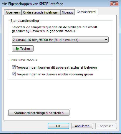

Btw, don't forget to tick the both checkboxes in the properties of the device - advanced tab (see below; never mind the 96K/16 shown there; it does nothing for Exclusive Mode).

I not sure which audio device is inside this laptop. The laptop is a F-Siemens, 2-3 years old. The device is named Realtek AC'97. When I try to use DAC Test, the Engine 3 stops executing. I have ticket both the checkboxes.
