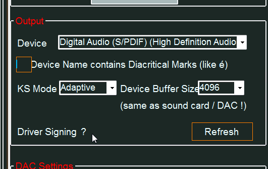

« Reply #1 on: August 08, 2024, 02:01:09 pm »
Hi Ramesh,
XXHighEnd takes care of that adequately. See below.

« Reply #2 on: August 08, 2024, 06:08:00 pm »
Thank you Peter. I tried modifying through XXHE and rebooting a couple of times without success.  Could be a problem on my side.
XXHE version 2.11.
Posts: 16858
« Reply #3 on: August 09, 2024, 03:02:49 am »
(maybe) Try to interpret that Refresh button as it is intended (LOL). The ToolTip on it could help.
I don't know better than hat this robustly works. But maybe it can conflict with your own setting (which is not persistent) ? Thus, reboot so that your own setting is out of the way, and then next work with the XXHE setting. And of course do that in non-RAM mode. When that works, you can boot from RAM and it will work from there too.
