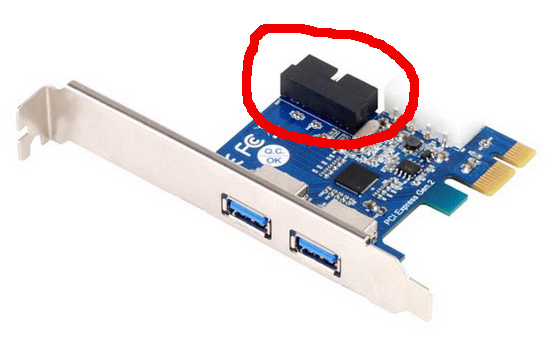

« Reply #59 on: January 24, 2016, 10:20:22 pm »
Another question: Do all NOS1a users with silverstone card problems have connected the power via molex plug?
Georg
