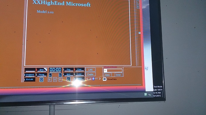

The problem now is that Windows10 10074 is no longer working properly. This is because I installed software to remove the watermark.However, it has caused more damage .. So I can not go into min operating system anymore. And the player will see the windows as windows xp or lower. With all its consequences.
The sound that I had is completely gone. It sounds okay, but it's not what it was.
Oh yeah , and a restore point , I never made .. :-( my stupid!
I suspect that a clean install is the only option ?
Michel

« Reply #19 on: September 19, 2015, 08:21:40 am »
Michael
Your problem is probably that windows service - "Windows Management Instrumentation" is not running. This can happen when Windows does not shut down properly.
Via control panel - admin tools - services, double click "Windows Management Instrumentation" select start "Automatic" then click Apply then click Start Service. Start XXHE now it should be OK but you may need to set memory type back to "Straight Contiguous".
I have my system clock set back exactly 2 years, this should allow W10074 to keep running 2 more years.
Colin
Hi Michel,
Colin is right, but possibly you can't get it done or it does not help. Also (now start crying) : I suspect that exactly that Winmgmt service has been eliminated by that piece of software you installed, because it would be typical for that service to check for the (watermark) data you had removed by that software.
Please notice that in your XX folder there are files like OSIsW8.tss, which when renamed to .tst let your system behave like it is implied by the file name. BUT, for W10 I did not make that yet for the XXHighEnd version you all use (it's there in 2.03 - not ready yet).
In your case you can try the OSIsW81 (for Windows 8.1) which will resemble W10 the best. But I think it won't work all the way ... You'd have to try it.

« Reply #25 on: September 19, 2015, 12:44:51 pm »
I've tried it(OSIsW81 ), but no luck for me today.

But what happens ?
The empty Playlist Area should now show Windows 8.1.
Does it ?
If not, I'd say your rename didn't work out as intended. Thus, has to be :
OSIsW81.tst
And only one at the time may be in there with .tst as extension.
