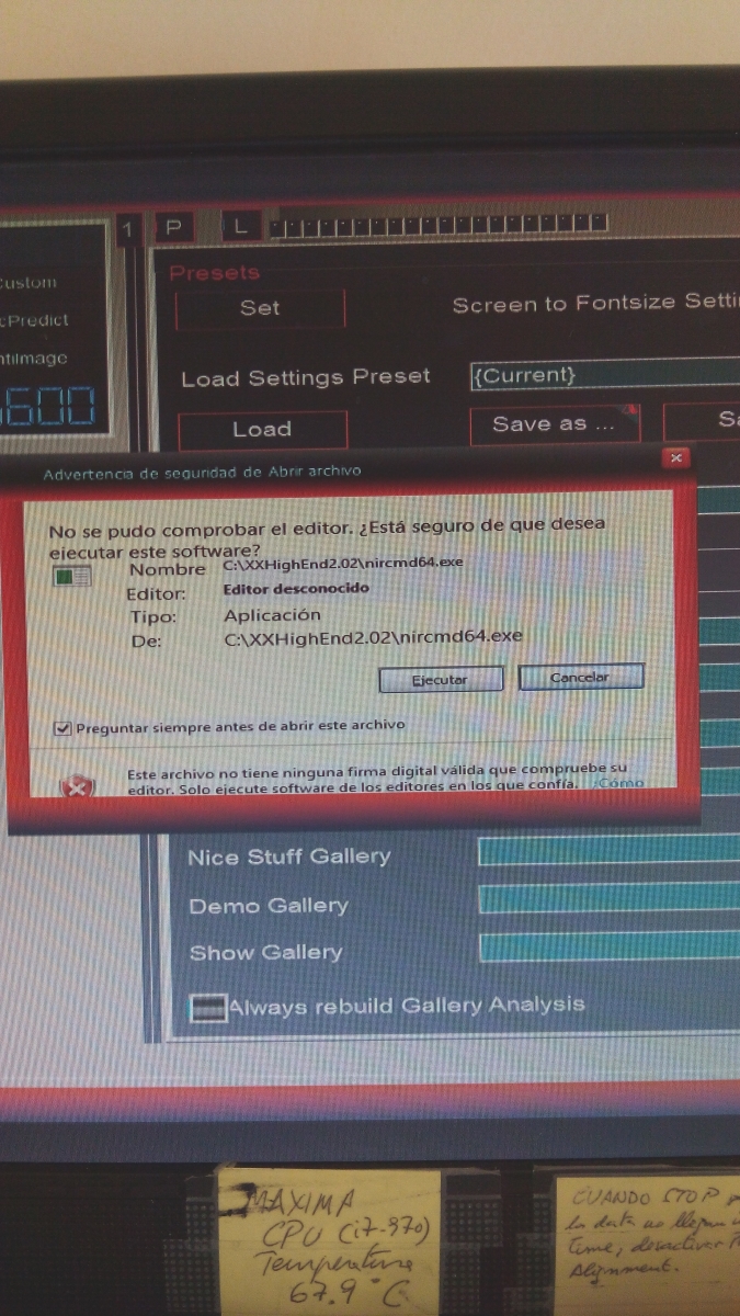

Peter, I´m trying the new XXHE 2.02 in W10-10074 in demo mode and found some issues.
When I click the S buttom to go to the Settings Area a message says (traslated from Spanish):
Not possible to check the editor.¿are you sure you want to run this software?
Name: C: \ XXHighEnd2.02 \ nircmd64.exe
Editor: Unknown
Type: Application
etc.
see picture 1 (in Spanish):
and I can´t go back to the Library or the Playlist Areas, to do it I have to restart XXHE and then, when I click in Clear and after closing XXHE and also when I click Play after starting XXHE and charging some album a message says:
Something went wrong at clearing the Proxy´s; A good reason for this is when a temporary file receive the Read Only attribute...
Error (this is just an example because it happens with all the albums): Access denied because the file "100_Black_volume_6--Frontal.jpg" it´s been used in other pro
cess.
I know that I made at least one thing wrong (probably more) when I installed XXHE for the first time, I did it too quickly and I don´t know if that errors have something to do with it. I made a mistake when several programs asked to initialize and instead click in "do not show this message again" I clicked "ok" (continue). I reinstalled again XXHE but nothing changed.
Do you think that I have to reinstall Windows 10? I rather to do it before I buy the Activation Code to avoid having to use paypal repeatedly .

« Reply #1 on: June 17, 2015, 08:08:29 am »
Thank you for that screenshot, Juan.
What happened is that you let the checkbox remain checked when the programs / popups passed by during the install process and now "Under the hood things will go wrong" as the very first larger screen promises.
So the programs must run and the checkbox must imply "do not ask for this again".
What you can do is Rightclick the "Save as" button near the top in settings, choose Reset, quit XXHighEnd and start again. I think the pograms/popups will pass by again so you have another chance.
Let me know if it helps ...
« Reply #2 on: June 17, 2015, 10:16:02 pm »
Thanks for the help Peter, it took me a while but the popups were gone. I uninstalled/reinstalled the OCX although I'm not sure if it was absolutely necessary. Later I played for a while with the Skings settings and the result looks pretty good to me. The size and resolution of my screen does not allow the perfect shape of images but I think it´s good enough.
