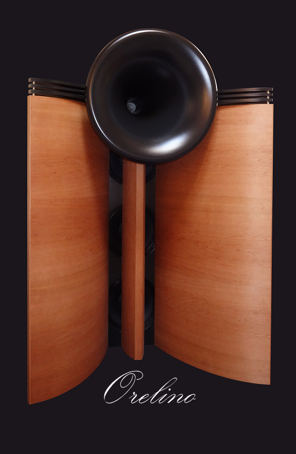

I just noticed Phasure and B-D designs presence on the x-fi in Veldhoven next week.
This looks like an ideal local opportunity to get myself a reference for WIN8 sound with Bert's latest creation the Orelino which looks mighty interesting.
I guess they are running in and being tuned at your place right now...

So what's wrong with this one?
Edit: As always, very interested in hearing what you think. And depending upon what you say, I may be in the market for a pair. If so, I'll be selling my Swings. If anyone here wants them, I'll be selling them for what I paid - i.e. 1/4 of their retail price!
Unexpected answer :
That I just had to change everything because ...
Because I heard a slight hum from the mid-high. Trafo-like.
So yes guys, these things don't happen only to you all - also just the same to me. Just get yourself a new couple of amps, speakers, and there you go ... AGAIN.
Still nothing should have changed ...
So many hours further and with taking many deep breaths to change a few rather drastic things for actually other reasons, it is my conclusion that a too closely mounted filter section (XOver) to the transformer or maybe other voltage regulators picked up in the filter coils etc.
Result ? to-tal-ly silent again.
If this wouldn't be me. I would have thought "oh well, some bit of noise with your ear in the speaker". But it was me, and with a dose of "reference" I couldn't sleep of it until it was solved. So it is now. Time for a re-listen ...
Loudspeaker filtercoils pick up a lot of stuff. Once I disconnected the amplifiersignal to the filtersection of one driver (you can do that with biwiring). Still music was playing though that driver at a low but hearable level. It turned out to be the coils of the filter coupling with eachother. With a relocation and repositioning I could attain silence. I was surprised how much apart they had to be even with orthogonal axes.
This is very noicable with efficient horns of course.
Plus I can make disconnected speakers hum by just touching the loose wires.
