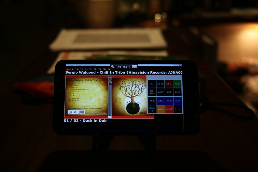

  • Switch on the Tablet and fire up your Remote session there. If you have done all right, you will see that XXHighEnd is somewhat too large. What you will see (because you started Playback already) is the WallPaper Coverart. This is convenient because it has a left border which matches the phycisal monitor's left edge (on the Audio PC and on the Remote PC) and further - OSD Text set to be shown assumed !) it has top and bottom borders denoted by the Album title at the top and the Track Titel at the bottom. Simply squeeze the screen on the tablet so top and bottom fit exactly and in the mean time drag the screen to the left edge.
  • Done ? then also assumed that the Height of the WallPaper Coverart is set so that nothing much disappears at the right side of the tablet's screen now (and otherwise your preparation was not right), fix your screen on the Tablet so it can't be dragged anymore. Notice that it is the advice to seek an "RDC Program" that allows for this, which e.g. TeamViewer can NOTdo on Android.
  • When you didn't do it already, extend your OSK so that the Shortcut keys show horizontally, and that's it.

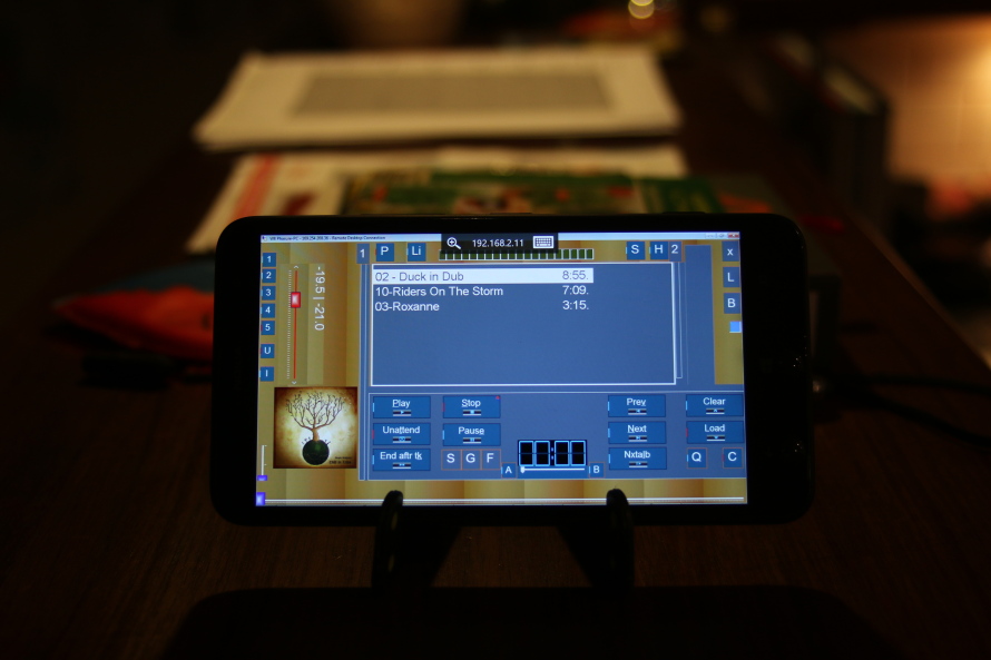

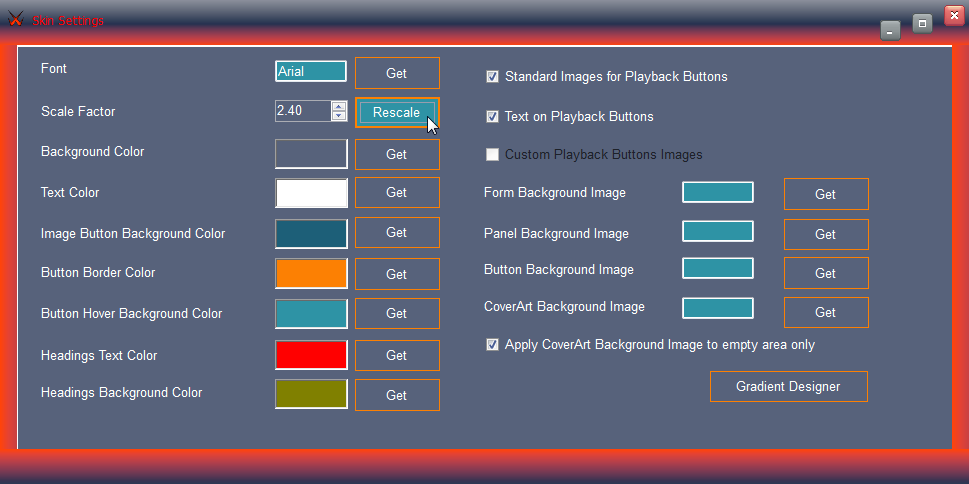

First off, there is the Scaling Factor. Target this to around 2.8 and you will be in the good direction.
Next there's the three panels to slide to convenient sizes;
The left one should be as small as possible, but still show the Volume Slider; if you are not using that, then this is not necessary of course. However, there's also the Coverart in the left pane you might want to see. The size of this is up to you, but notice it will go at the cost of the middle pane, hence the tracks to play and the Library Area.
What you will be in lack of the most is height. So, keep this in mind, and don't format the XXHighEnd form less tall than necessary.
The right pane, meant to show all the Coverart available with the active album, is not necessary at all. So, make this as small as possible.
The Library Area (middle pane) is the most important, because there you will be selecting your albums. It is the trick here to conveniently see which albums are there to choose from, and this is related to the combobox at the bottom, which by default says "Text Under". Choose here "One line/Group" now, and you will notice that the Album Title etc. will be quite conveniently readable ithout further tricks. This allows one album per row only, but it is more convenient than 2 or 3 without being able to read the text otherwise than holding your finger on the album so the Title pops up in a ToolTip.
The size of the Coverart in the middle pane should be chosen so that you can a. conveniently see which album it is about and b. you can scroll a few at a time. So, obviously making the Coverart so large that only one fits in the middle pane makes it highly visible, but scrolling will go one by one and will be tedious. But, all up to you, if you only recognize the possibilities.
Where it is your aim to make all as large as possible (so your fingers can easily tap the buttons etc.), it is easy to make the mistake to cut off so much of the right side that the Clear and Load buttons are not in sight anymore. But you need those ! So, leave those in side, and notice that when they are half visibe only, it is enough to conveniently tap them.
Lastly, at tuning in things, you must ensure yourself that the X button at the top right of XXHighEnd is visible on the Tablet. So, it is quite easy to in there drag all so that the height fits, but that a right part is cut off outside the Tablet's screen. Now you will have cut the X button as well, but you will need that ! (see at the mousepointer below)

  • For the latter reason, the final calibration is always done by looking at the WallPaper Coverart. That is, if you use that (but of course you do). Thus, start an Unattended session of XXHighEnd with the OSD WallPaper switched on, and now concentrate on the top and bottom OSD texts. They must just fit the top part of the tablet's screen, as well as the bottom part. Also, the texts should start at the left edge, which is what the WallPaper does as well (this is why you must align XXHighEnd at the left edge of the source PC just the same).
  • The right edge of XXHighEnd is theoretically determined from the right edge of the WallPaper Coverart. Notice though that not all Coverart will be exactly as wide, which is for yourself to judge, and obviously depends on your own applied scan sizes. Now, when the right edge of XXHighEnd is too much to the left, you will be working with an unnessary narrow XXHighEnd screen, *or* ar dragging it larger, you will look at cut Coverart at the right side.
