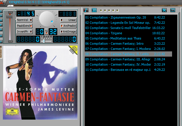

Try your SFS capabilities just with Attended Playback ! Once you found the limit, maybe go 10 or so under it.....
So ... I just claim that the largest size is the best...
How do i recognise this limit? Is that the message box telling me to lower the SFS setting or ......? Yesterday i had SFS 500 in Mixed mode (i think) without any message. But I had the impressing that i had a suddenly long break between the tracks.... I will test it again this evening.
