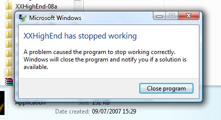

I have downloaded 0.9d and tried to run XXHighEnd.exe, but it immediately displays a window that XXHighEnd has stopped working. Under the "problem details" it displays this:
Description:
  Stopped working
Problem signature:
  Problem Event Name:   CLR20r3
  Problem Signature 01:   xxhighend.exe
  Problem Signature 02:   1.0.2733.34784
  Problem Signature 03:   46871379
  Problem Signature 04:   XXHighEnd
  Problem Signature 05:   1.0.2733.34784
  Problem Signature 06:   46871379
  Problem Signature 07:   b
  Problem Signature 08:   d0
  Problem Signature 09:   System.InvalidOperationException
  OS Version:   6.0.6000.2.0.0.768.3
  Locale ID:   1033
I am using Windows Vista Home Premium (64bit) and of course I have turned on the .NET Framework 3.0 feature and am using DirectX 10.
Thanks for any help on this.

Ok, "officially" it should just work;
Could you please try withgoing zip ? Put the exe coming from it in your XX directory, and start it.
Several numbers and characters come by (like 001, a, b, c, d, etc.);
Would be so kind to report back what those numbers and characters are before it errors out ?
I hope it even comes up with the first ...
Thanks.

« Reply #3 on: July 08, 2007, 10:52:17 pm »
Thanks.
I tried it, but it does exactly the same as before. Immediately displays the "XXHighEnd has stopped working" window (with the details I listed before). I do not see any display of numbers and/or characters as you mention.

« Reply #4 on: July 09, 2007, 07:42:31 am »
This one is explicitly compiled for X64 only.
Also ... In your XX directory there will be 4 Microsoft.DirectX DLLs. These 4 DLLs might bother you and you could move them out of the way temporarily. If this latter helps, do not start playing and listening to this 0.9d-2 version, but go back to the normal 0.9d (but leave those DDLs out).
Edit : Removed the zip (did not help).

« Reply #5 on: July 09, 2007, 07:04:53 pm »
This still does not work and behaves exactly as the previous.
Peter - I think it's time to stop right there. You do not mention in your "prerequisites" that this only works with Vista (32bit), but it's clear to me now that this is true. So the first thing you need to do is re-write the prerequisites to say "not currently supported in 64bit Vista". Second of all, you are asking for money for this program which implied to me that you have a finished product, but it's clear that you are still in development and testing. What you should have done is declare this a beta period and select private beta testers to do all your testing, while you iron out the bugs, and do not release (or charge) the public until all testing is concluded. From your comments to me such as "I'm not even sure what to do", "it should just work", "these might bother you", it is clear to me that you do not even have 64bit Vista, nor have tested it before with 64bit Vista. It is inappropriate for you to charge me for a program and then ask me to be a tester for you just to get it to work. I'm sorry, that is not how software development works. If you want (and need) me to be a tester for you, then I would be happy to *IF* you ask me and offer to either pay me or give me your program for free. I'm not trying to be a leech off of you. I'm just explaining how business works. I totally understand that you are new at this and this program is still under development and I can appreciate this exciting process and would like to be a part of it. But this is not how business works and it is inapporpriate to be charging money during this period. If you simply want to tell me that this program is not ready for 64bit Vista (and you re-write your prerequisites) then I will totally understand, and wait for the final version. (Or you can PM me with an appropriate offer)
