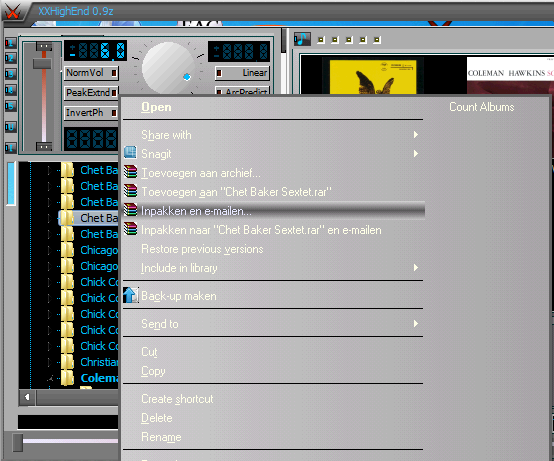

Problem with the reading of the menu options after a right click in the Gallery structure. White characters in a silver background colour.
Thank you for mentioning this Johan. I forgot about this one. N.b.: I tried to make all these "context menus" the same, but couldn't manage, so the internal ones I solved, but forgot about the external ones (like the one you showed).
