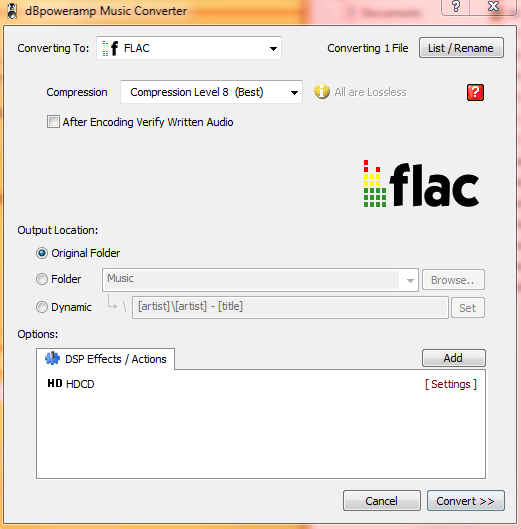

« Reply #5 on: March 20, 2010, 09:14:07 am »
Hi Jarek and others,
I just checked-out DB poweramp with HDCD plug-in, very handy this way, because it checks a lossless file for HDCD info
before converting. (Because sometimes there is no info that the album is actually a HDCD)(also good marketing move)
"This little tool will input the 16-bit WAV data and if it finds the embedded HDCD info, it will upconvert it to 24-bits. The last 4 bits of this 24-bit file are empty, so your DAC just sees it as a 20-bit file"
Look here for more info
It creates a 24bit file because otherwise you can not convert it to FLAC for eg. (does not support 20bit) leaving you still with a big file.
Now you have a HDCD FLAC file (or whatever lossless file)
Interesting because I can truly compare the files using DAP with XX.
Sounds good to me!
Will do some more converting, have some more HDCD's to compare.
There is a partial list on HDCD releases here
Roy
Just select the HDCD plugin from the DSP Effects/Actions, see below, thats all.
