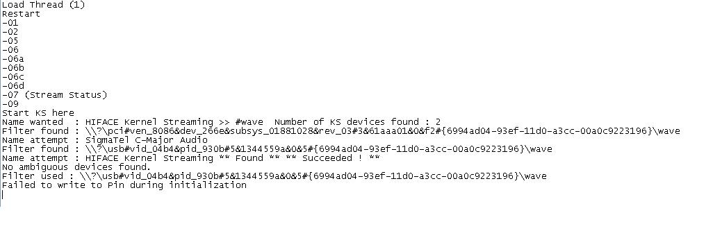

Hi peter,
I just downloaded & tried this with my HiFace - the good news is that it recognises the HiFace - te bad news is that it fialed to write to pin during initialisation. I tried it with settings at 24bit/192 & 32bit/192. Same error in both cases.

This not assumed, I guess I need to build in some more log data to find out what is going on. But by now it sure starts to look like USB is not working for most of you. On this matter, please let know your system (and maybe better put it in your signature so it allows me to compare easily with others), also knowing that USB wasn't supported by KS forever. So, I have the feeling that something must be added in order to let USB work properly. But what ?

Haven't tested the last update, but with 9y-5.01 kernel streaming works perfectly with my M-Audio usb device. The Hiface, however, does not.
But is the HiFace being recognised properly now as in my log printout above?
Yes, but it doesn't say all for two reasons (I know by now) :
1.
I expect the HiFace to be a "DAC Needs" 24 bits device, while Engine#4 isn't prepared for that currently (in the area this has to be created this is relatively complex plus I have no "24 bit only" device to test it with -> no solution as long as that situation remains);
2.
There is something with USB which is "different", and I'm not sure what it is yet. A few minutes ago I tested an USB DAC, and while everything looks good, it just doesn't produce sound. It is my estimation that when I solved this, chances for other USB devices will be a lot higher. Happy I am working on at least this right now !
