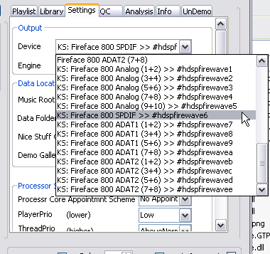

    A main culprit for Kernel Streaming is that the normal list of devices as you see it from rightclick the speaker icon in the taskbar tray (I talk Vista/W7 here) is not the list of Kernel Streaming devices. It will count for Direct Sound and WASAPI (in general "WDM") and all, but not for KS. However, if all is right and devices listed support KS, they can be found. However :
    A "feature" of Vista/W7 is that the names of the Sound Devices can be changed by you, the user. However, this is also applied by sound card vendors, and what you see there may be different from how things are being called internally. This means that the name you see and choose must be matched with the internally used name, and this is what the KS Device Selection from XXHighEnd tries to do. This also means it may fail, and if it fails for the reason of the name which doesn't match, nothing is lost, because you can change the name ... (first property page of the device).
    Notice that for XP this is no problem, and the device names you see in the (XXHighEnd) list, are the same ones as used internally.
    Right. After clicking play - or things play, or you receive a message indicating that your device doesn't allow KS or can't play otherwise.
    It now becomes important to tick the Log Activities checkbox (Settings Area at the bottom) and watch for the X3PB log file in the TemporaryData folder under your XX folder;
    In there you will see a list of all the KS devices which can be found in your system. Just look for the readable names which you will recognize (at the "Name attempt :" tags, and skip the more unreadable names and (GUID) codes. If you see the device you want, but received the message "doesn't support Kernel Streaming", just try to change the name of the device and try again. Don't forget to keep track of which name you change into what, or otherwise things may become a bit messy. Don't forget to quit and restart XXHighEnd to let reflect the new names in the list.
